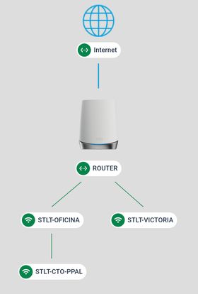

I'm looking for help to determine if I have to tweak any setting due one my satellite (3rd floor) not providing ISP download speeds, let me explain a little bit but before I will provide the system information:
Model: Orbi RBR750
Satellites: 3
Distance between each one: around 17-20 ft passing signal through wall of concrete and some wood
ISP speeds: 350 MB up and down
Router speed: 350 up and down
STLT-OFICINA; 350 MB up and down
STLT-VICTORIA: 350 MB up and down
STLT-CTO-PPAL: 350MB up and 200 MB down
This is the network map:
I had a previous ISP where I had the exact same speed and exact same setup and satellites location, all the satellites and router I was getting 350mb up and down, few months ago I changed from ISP and I get the same speed only on two of the satellites, the 3rd one I'm only getting down 200 mb and sometimes 250mb, and upload speed I'm getting the 350 mb.

    Thanks for confirming the test protocol.  There appears to be nothing obvious that would make the results for one ISP be different than the other ISP.  In a way, it is amazing that the third satellite achieves such performance after making "two hops" (router to OFICINA, then OFICINA to PPAL),
