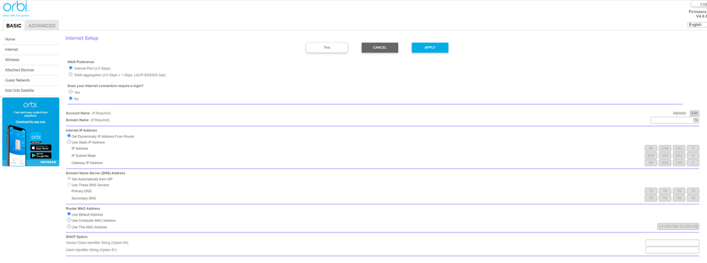

greyed out DNS in web app
Hi. I have the below Orbi 6 and suddenly the "Use These DNS Servers" option under "Domain Name Server Address" option is greyed out, even though I have been using public DNS servers through this interface for years. It appears that I am now being forced to use Comcast's DNS servers ("Get Automatically from ISP" cannot be unselected). I prefer to use public DNS servers. How can I get back the ability to add custom DNS lookup for my Orbi? Thanks
Hardware VersionRBR850
Firmware VersionV4.6.8.2_2.1.9

    • daledx00's avatar
      daledx00
      screenshot attached - you can see the DNS options are greyed out and Comcast's DNS servers are in there.

    • daledx00's avatar
      daledx00
      Disabling Armor has no effect. Even when Armor is active (as it has been for years) I could always use custom DNS servers before. Now whatever has changed is forcing the use of Comcast's DNS servers (I looked up the IP address and it is Comcast). Couldit be that Comcast is forcing NG to disallow non-Comcast DNS servers? I tried resetting the Orbi but no change.
