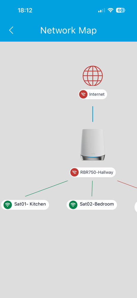

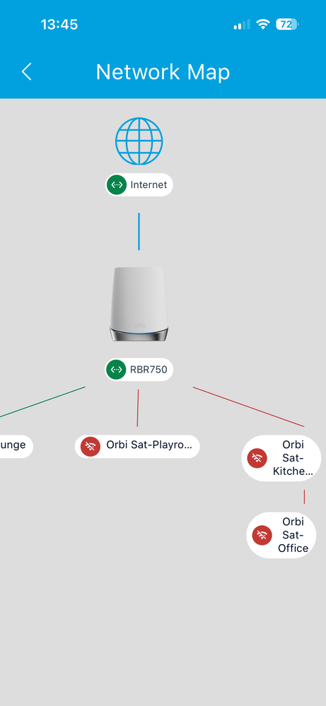

I am having so many issues with my orbi 6 router and satellites
I am having so many issues with my orbi 6 router and satellites. Constant drop outs lose connection with internet. One minute it’s fine then gone. I’ve tried reboots, reinstalls, turning off iv6, turning off firmware updates, moving routers, changing channels.. it’s endless. Stable for a day then dropouts for no reason?!
I am using a virgin media router (in modem mode) with a v6 orbi and several satellites. Orbi constantly losing internet connection. I’ve tried everything the forums have mentioned short of throwing it away given the cost of it. Can anyone think of anything else I try before I sell this thing?! Thanks .
  • IF your not getting internet at times from the ISP, then could be an ISP issue between them and there modem/router that the RBR is connected too. Red means the RBR isn't getting good signal from the ISP modem. Have them check everything up to there modem.
    Cam use there router in router mode and connect the RBR then and see if the RBR still continues to see RED in the app. Use the ISP routers DMZ for the RBR in router mode.
    Or try AP mode on the Orbi system with the modem in router mode.
    What Firmware version is currently loaded on the RBR and RBS?
    Be sure your using a good quality LAN cable between the modem and router. CAT6A STP is recommended.
    What is the size of your home? Sq Ft?
    What is the distance between the router 📡 and satellite(s)🛰️? 30 feet or more is recommended in between RBR 📡 and RBS 🛰️ to begin with depending upon building materials when wired or wirelessly connected.
    https://kb.netgear.com/31029/Where-should-I-place-my-Orbi-satellite ‌‌🛰
    Does this happen with the RBS turned OFF?
    Does this happen with both wireless and wired devices?
    What channels are you using? Auto? Try setting manual channel 1, 6 or 11 on 2.4Ghz and 40 to 48 channel on 5Ghz.
    Try disabling the following and see:
    Armor, Smart Parental Controls or Circle, IPv6, Traffic Meter.

    • Timo40's avatar
      Timo40
      Hi, thanks for the reply. I am now using the orbi in router mode as you suggested, so far so good. No dropouts for 24hrs. I have lost the first account option which is a shame but have I lost any performance in terms of speed etc or are the speeds I’m getting from my isp the speeds I would have got anyway with the orbi router? Thanks again, really helpful.
