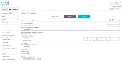

      cdysthe
      Virtuoso
      FURRYe38 I was too eager to declare this problem solved. This morning the IPv6 IP was dropped and no new IP assigned. The message in the web control panel is that IP is 'not available' See screenshot
      IPv6 not available.
      I'm sorry I declared the problem solved yesterday but I did at least include a reservation.

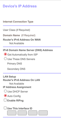

    donawalt
    Hero - Experienced User
    Well, I went 24 days with solid IPv6, this morning there was no IPv6 address - and as you can see from the posted image, it was not like the other times that I thought the latest firmware fixed, where an IPv6 address showed on the router page, but the IPv6 tests failed - as you can see, there is no IP address at all reported by the RBR850! All I did this time was just click "Apply", and it came back with an IP address. Is this related to a lease renewal, or on anomaly, or ...? I'll keep a log and keep watching it. It will be interesting now to see if something happens in another 24 days. Let me know if there are any ideas to check since this looks different than before.
  • donawalt's avatar
    donawalt
    Firmware is V4.6.8.5_2.1.9. It worked for 15 days.  Both the IPv6 test page and Orbi router page indicate no configuration:
