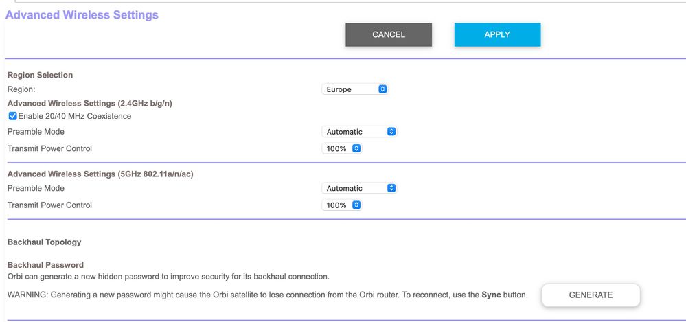

What is the distance between the router and satellite(s)? 30 feet or more is recommended in between RBR and RBS to begin with depending upon building materials when wirelessly connected.What are the walk materials made up of? Any concrete?
https://kb.netgear.com/31029/Where-should-I-place-my-Orbi-satellite
https://kb.netgear.com/000062035/How-many-satellites-can-you-add-tWhat channels are you using? Auto? Try setting manual channel 1, 6 or 11 on 2.4Ghz and 40 to 48 channel on 5Ghz.
Any Wifi Neighbors near by? If so, how many?Try disabling the following and see:
Armor, IPv6 and Set 20/40Mhz Coexistence to 40Mhz only. Set Short preamble instead of Long preamble modes. Save settings and reboot the router and satellite(s).- xdwt44Aspirant

I can modifiy the channel for the channel 2.4Ghz but not 5 it's greyed out.
Since I have done the following settings, my satellite are not joining anymore, even by reseting them or bringing them closer..
