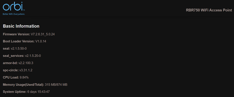

  • Seeing similar issues after upgrading to my 750 series devices to 7.2.6.31
    Devices will drop connections randomly, and I'm seeing intermittent streaming media issues where I had none before.
    All devices will eventually migrate their connections to the RBR750 after losing their connections to the RBS750s (I have two) regardless of how close to the RBS's they are.  Basically at this point I no longer have a mesh network as within a day or so everything ends up on the RBS.
    Upgraded after staying on the 4x for the last year after Netgear's last firmware mess that left users unable to connect to the management interface. Should have known better.
