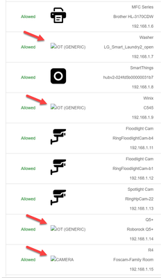

  • Updated to 7.2.7.15 about 40+ days ago for my RBK853 without any connectivity issues so far, but have noticed a weird oddity on "Attached Devices" pages that shows the connected clients/devices on the GUI, and some of the icons for the device type don't show up correctly:
    Tried clearing the cache/history on the browsers and also tried different browsers (Chrome and Edge) and no difference.
    Anybody seeing this weird issue as well?

      Just manually assign the missing icons, I noticed this when I updated and then reverted back to the previous firmware.

        I also had the issue with the icons missing for some devices aswell.
        A factory reset and setup from scratch fixed this issue for me.

      I haven't. Though I had installed FW and then factory reset and setup from scratch. It is posted in the first post that if odd issues are seen after a FW update, a factory reset may needed.
