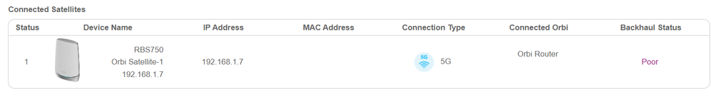

        And here's the weird thing - I don't have ANY of the satellites plugged in or turned on but my netgear login to router page shows this:
        How can I have a satellite connected when none are plugged in?
