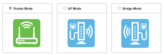

      The "advanced setup" of the R9000 has this:
      Maybe not worth the effort?  As you say, not much going on in the garage (just some lights and the garage door opener).

        Bridge mode isn't repeater/extender mode. (Sadly)
        Basically turns it into a wireless switch. Only the Ethernet ports work for devices in bridge mode. It uses the wireless as a backhaul connection to the router
