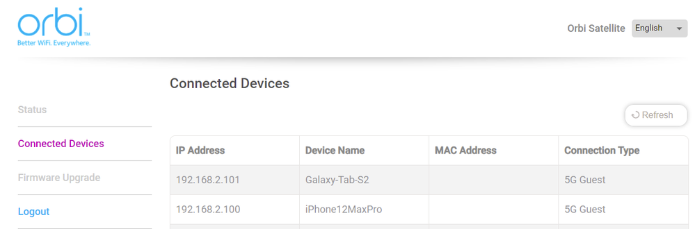

    • FURRYe38's avatar
      Thought I didn't get a chance to test router mode, I had my 8 series already in AP mode so I connected it up to a R7960P.
      I first tested the RBR with an Iphone...I was able to get my iPhone 12 Max Pro connected, though the first time I noticed it quickly disconnected and went back to the primary SSID. I tried a 2nd time and the phone then connected, however a "No Internet" message was seen on the phone for several seconds. Then that went away and it finally seemed to fully connect and set internet.
      I turned on 1 RBS downstairs and let it sync. After about 5 minutes it was fully synced.
      I took my iPhone and a Anderoid pad downstairs near the 1 RBS and both devices connected and remained connected.
      Leaving my devices there, I went back up stairs to my PC and captured this:
      The 192.168.2.### confirms they are on the Guest Network.
      This is in AP mode. I'll try and find some time to test router mode.
