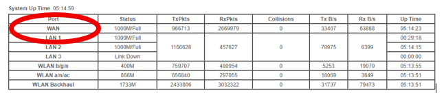

        Another bit of information to gather the next time this happens is to navigate to the web interface Advanced Tab and click on Show Statistics.
        Next to the WAN port, does it say 1000M/Full or 100M/Full. ?
  • The CAT cable was what was provided with Verizon which was a AWM E212689 Style 20276 80'C 30V 28AWG CAT.6A Cable.  This is going straight from the ONT to back of the Orbi Router into the "Internet 2.5G/1G" Yellow port on back of Router.

        Alright, I swapped it with a KASIMO CAT8 - 2000MHz S/FTP PIMF Patch Cable PVC... It switched to 1000M/Full and speeds went up to 500/600 Mbps. I will keep eye on it and see if it goes down in the next couple of days.
  • This seemed to be the solution. Bad cable leading from ONT to router. Was a flat ethernet cable that was provided by Verizon. Maybe there was interference building up with it since the wires aren't twisted? Not sure but been getting consistent speeds without rebooting router. Thanks!
