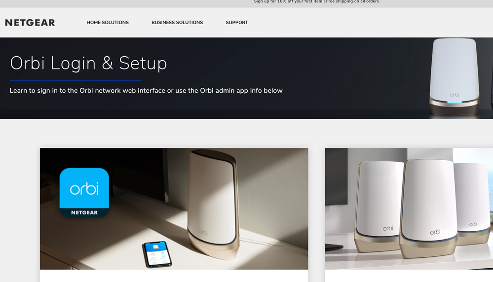

orbilogin.com "admin" pop-up not there
My internet was getting a little slow and lagged at times. So, I went to at AT&T's website and used the "Restart Gateway" option. I have the Motorola BGW210-700. No problem! Internet is running fine!
Knowing that AT&T U-Verse can be a bit wonky with my Orbi RBR750, I wanted to make sure that none of the settings got reset or messed up.
However, when I attempt to login into orbilogin.com the pop-up does not appear so that I can enter the "admin" username and password (which I do not remember". It just goes to https://www.netgear.com/home/services/orbilogin/ . I am using Safari. Is there something I am doing wrong?

    Are you trying to access orbilogin.com or 192.168.1.1?
    What browser are you using?

      • I am trying to access orbilogin.com
      • I am using Safari

        Try Firefox or Opera and 192.168.1.1 and see if you can access the RBRs web page.

    I understand that you are having issues accessing your RBR750 through orbilogin.com.
    Please ensure that the device you are attempting to access the Orbi's admin from is connected to your RBR750 network.
    After confirming that the desired device is connected to your RBR750 please navigate to orbilogin.com and enter your login credentials.
    Let me know if you have any additional questions!
