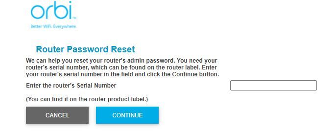

Hello All,
I have recently bought an Orbi AX6000 ( RBR850 + RBS852)
I never could connect to the orbilogin.com or .net, nor via the Ip address as I am always prompted with the hereunder message no  matter the method.
I am well connecte to the orbi network in wifi ( router mode as I can change to AP since I don't have access to the config page obviously ), and I also have tried with ethernet cable.
The browser I use is chrome and explorer to try to get there.
DO I need to reset to factory settings at this stage ?
Thanks

    The result as stated in the very first message is the same
    I just tried again on http://10.0.0.1 and same issue
    If you see "Router Password Reset" screen then it means you entered the wrong Username/Password.  If your browser is not displaying a popup dialog to enter Username and Password before showing the page, then something on your PC is preventing it from appearing or blocking the input.
    Have you tried going to http://10.0.0.1 on another device, like your phone's browser?

      Well a factory reset is what I wanted to avoid obviously .
      On the first setup I did well put a username, passwrd and assigned two retrieval questions, actually I am using these credentials o log in, but I always end up on the same screen

        The password recovery feature is flawed. If you don't know the answers, don't type the right, or didn't set them up, it still tries to run password recovery but just loops.
        Its why I think the password setup was either not correct or flawed

    It is very strange that if your device's network gateway is configured to your Orbi in Router mode that going to that IP address doesn't access the Orbi's admin website.  When you try the IP, what is the error displayed by the PC browser?  If this is on a laptop, can you also try on a different device, like your mobile phone's browser?
    If this is a PC, can you Win-R "cmd" and give us the output of "ipconfig" for IP Address / Default Gateway and confirm this is the IP address of your Orbi?  For example mine shows:
