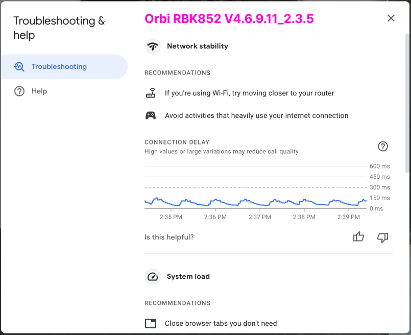

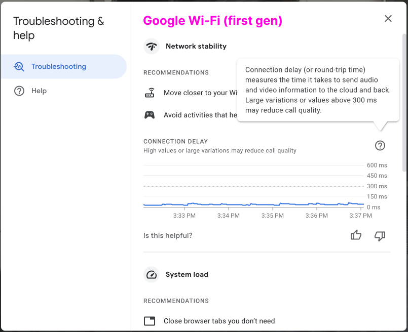

RBK852 is giving me high latency/delays during video conference (coming from Google Wi-Fi)
I recently switched to an RBK852 system from Google Wi-Fi because of various speed and coverage issues.  The Orbi system blew my mind: 3x speed improvement, full coverage, fewer satellites. Everything seemed good until I joined vc meetings using Google Meet... voices seemed garbled, I was talking over people, reactions were delayed.
When I pulled up the troubleshooting/monitoring graphs from within the Google Meet UI, I noticed this predictable pattern of latency/delay. Even though it stayed below the 300ms threshold, my experience was still impacted. I tried different places throughout my house, same issue. When I switched back to Google Wi-Fi, it was much more stable.
Does anyone know what's going on? My Orbi settings are default. This is on a 2019 intel Macbook Pro running 12.6 Monterey (if it matters). Should I tweak some settings on the router? on my Macbook? Unfortunately, if I can't fix this, I need to go back to google wi-fi (even if it has slower speeds and worse coverage).

      • Both of the graphs are wireless.  When connected via ethernet using a 100ft wire into a switch, the graph is pretty much a straight line pinned to the bottom.
      • In the graphs, the placement of the routers and laptop are in the exact same place. I made sure that the laptop was connected to router (not satellites) which has one wall and "full cabinet" in-between. Can't be more than 12 ft. House is from the 50's, thin wood walls. But also, i tried this with direct line of sight to the router and again with a satellite. I got the same graph.
      • When it comes to settings, they are all default. Coexistence and WMM enabled, CTS/RTS is 64, Preamble on auto, transmit at 100%.
      • 2.4Ghz channel is on Auto, 5GHz channel is on 48 (I don't think 5GHz has an auto option, right?)
        • ➡️ I'll experiment with the channels (I'll see if I can mimic the Google Wi-Fi settings too). I definitely see other SSIDs, so I have neighbors with Wi-Fi. I need to find a good/simple Mac Wi-Fi monitor/analyzer tool to better understand which channels are crowded.
      What get's me, however, is the predictability of the graph... every 45sec or so there is a bump/build-up in latency. It doesn't feel like random noise/congestion/connection-quality. And why everything else is better with Orbi, except this VC issue. That's why I was hoping for a "oh, yeah, that graph shows that you should [do this thing]" type of solution. One thing that I wish I could test with Orbi is setting a "priority device" like I can do with Google Wi-Fi, it may have helped in troubleshooting.
      Google Wi-Fi also has explicit toggles to prioritize video conferencing and gaming.  I'm guessing WMM is similar? But its a bit opaque about what it actually does.
      Additional info if it helps: I have about 50 devices connected. A lot of IoT. Nest/Ring cams. Good mix of 2.4 and 5GHz.

      • Regarding the testing in the browser (and probably goes for the old modem too)... the thing is, all other factors being the same, when I use the Orbi, I'm getting strange round-trip/latency issues - when I go back to Google Wi-Fi, they are gone. That's the frustrating part. As I mentioned in my original post, everything else seems fantastic (3x speed improvements, 2-3x better ping, better coverage, etc)... I would have expected VC latency to have improved as well. ( I'm literally just taking the ethernet cables out from Google Wi-Fi and putting them into Orbi - and vice versa - well, and also making sure to power off the system I'm not using).
