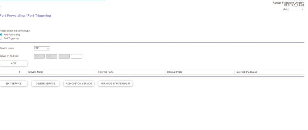

Hello,
My RBR660 and 2 satellites were installed in August 2025. DNS and port forwarding were completed as well. An AUTO firmware update occurred and three things happened.
- The DNS got lost and needed to be re-programmed. This worked well, although annoying.
- One satellite fell off the network and had to be reset. I have since turned off auto updates of firmware.

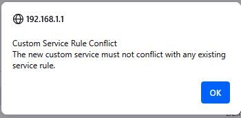

- All the port forwarding doesn't show when on the web interface. The ports are forwarded but are not visible in the web GUI. I tried firefox, edge, and edge in compatibility mode; all without luck. I tried entering a known existing port-forward custom rule and I get a pop-up advising of a conflicting rule. I also added a new rule as a test port forward and the new rule appeared in the GUI but the other ports didn't. I was able to delete the test port forward. Phone customer support was at a loss and the call dropped a few times without them calling back. Two photos attached for referenceCustom Ports not showing in GUIRule conflict from router
Thanks in advance for any help with #3.

- RBR660port-fwdAspirant

Factory reset already done, forgot to mention that. FW version is Router Firmware Version V6.3.11.3_1.6.88, upper right of photo.
Thanks
