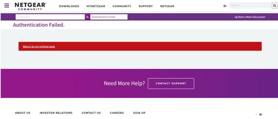

        BTW#2, I am frequently getting "Authentication Failed" errors on ths Netgear Community website (i.e., I will attempt to post a response like this one and sometime they go through and other times I get a "Authentication Failed" response (see attached screen shot).  I wonder if this is a related problem?
