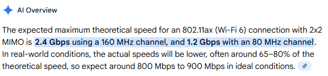

    An Ookla Speed Test run on a device with 802.11ax, 2x2 MIMO from very close to the WiFi access point (not even one wall) should exceed 500Mbps  (the Orbi 750 has an 80MHz channel):
    At 40 ft. distance, with a couple of walls in the way, then performance will be under 500Mbps.

        Wireless can be slower than ethernet and most times it will be. Some devices are only 2x2 MIMO supporting so seen speeds past 500Mbp +- maybe a limited to that bandwidth support. Devices that have 4x4 MIMO can get well over 500Mpbs and should see up or past 1Gb.
        Those are good speeds for general stuff.
