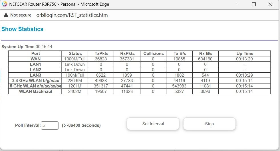

      Does the RBR web page under Advanced tab/Show Stats show 100Mbps or 1000Mpbs for the WAN port speed?
