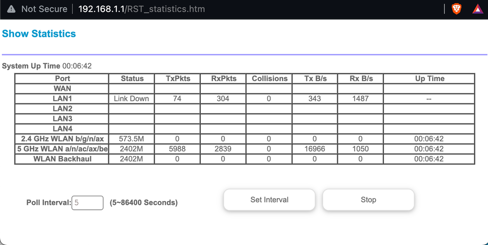

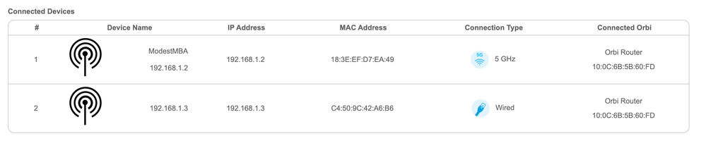

  • So this seems weird to me. Looking at the RBR850 admin page, can someone help me decipher this?
    ModestMBA is the laptop I'm using. The other device (C4:50:9C:42:A6:B6) is my modem. Is it normal that the router would be assigning an IP address (192.168.1.3) to the modem? That isn't what I would expect and seems to be indicating that it doesn't realize the modem is a modem or something?
    Then in the image below, there's no activity showing but there IS activity showing on LAN1. The only ethernet cable connected to the router is on the yellow LAN port (visually double-checked). Wouldn't I expect to see activity showing here on the WAN port and not on the LAN1? Taken together with the IP address thing above, it almost seems like the RBR850 thinks the modem is actually connected to LAN1 instead of WAN, and therefore doesn't know it's a modem and is instead trying to assign an IP to it like a regular connected device. But I'm not sure if that's just me not understanding how this typically works?

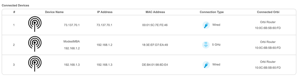

    • popechild2's avatar
      popechild2
      Guide
      One more data point. If I keep watching the connected devices page, occasionally a third item pops up. This shows up as a wired device, but the only wired device is the modem. It appears to have an external IP address, like I would expect the modem to have. But the MAC address is not the MAC address listed on the modem. When I goggle it, it brings up another manufacturer that appears to make chips that are sometimes present in modems.

      popechild2 wrote:
      This would seem to indicate that the Orbi router is not connected to the xFi box at all. (WAN port status is blank.)
        popechild2
        Guide
        Yes, that's what's strange to me. Because the xFi is definitely connected to the Orbi and it's definitely connected on the yellow Wifi WAN port. And the Connected Devices list shows the MAC address of the modem, so it's "seeing" the modem somehow, which again is connected to the yellow WAN port.
        Also, nothing is connected to the LAN1 port, but there's activity showing there.
