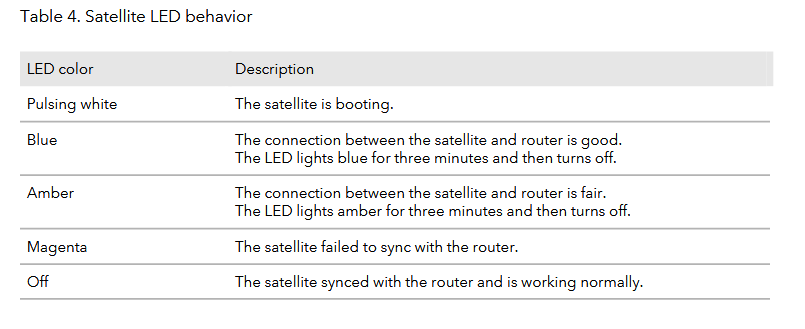

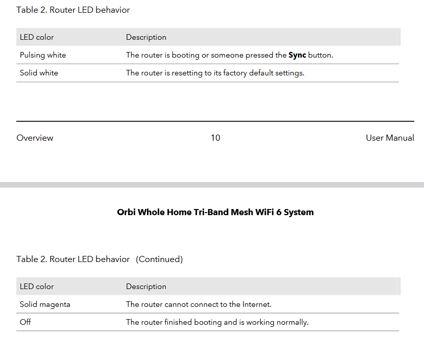

  • CrimpOn's avatar
    CrimpOn
    No LED light is supposed to indicate "all good":
    There is no option to "turn off" or disable the primary WiFi signal on any Orbi WiFi router.  Both 2.4G WiFi and 5G WiFi should be active.  If there is no 2.4G WiFi signal, that Factory Reset might be the next step.
