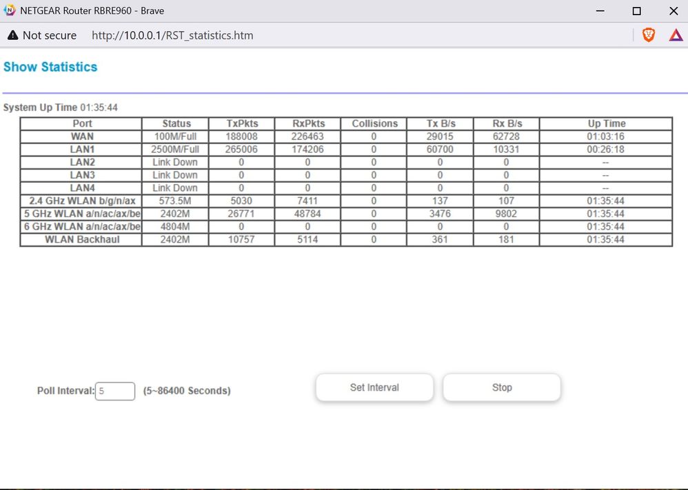

It works. However, it will only do 100 Mbps, the WAN is at 100M/Full. The Lan1 2500M/Full

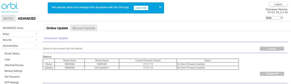

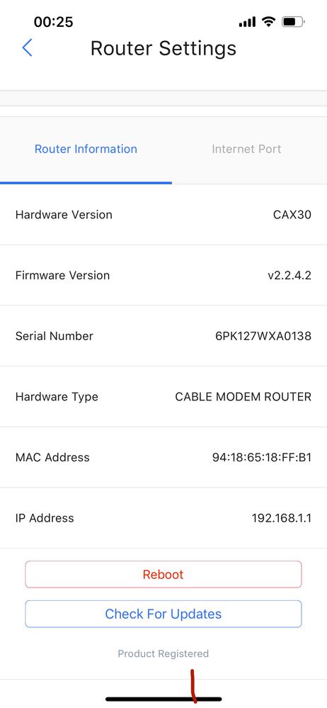

    What FW version is loaded on the 960 series and CAX30 modem?
      • Firmware on the 960 =  v7.2.7.15
      • Firmware on the CAX = v2.2.4.2

        Does the CAX30 have a Show Statistics feature similar to the Orbi router?  It might be interesting to observe how the CAX30 and the RBRE960 describe the Ethernet link between the two devices.
        What happens when a different Ethernet cable is used to connect the CAX30 and RBRE960?
