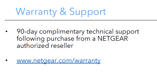

    Curious how these Orbi units were purchased. (Amazon? Best Buy? Costco? Netgear direct?).  According to the Product Data Sheet (https://www.downloads.netgear.com/files/GDC/RBRE960/RBRE960_TS.pdf  ) Netgear provides this support (page 2)
