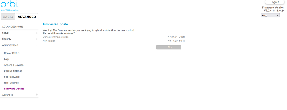

        So uhh, new development. Apparently I am physically incapable of wanting to downgrade my firmware.
        Additionally, I did the factory reset. It didn't appear to help anything. This is the problem I encountered just trying to downgrade to the oldest firmware available.
