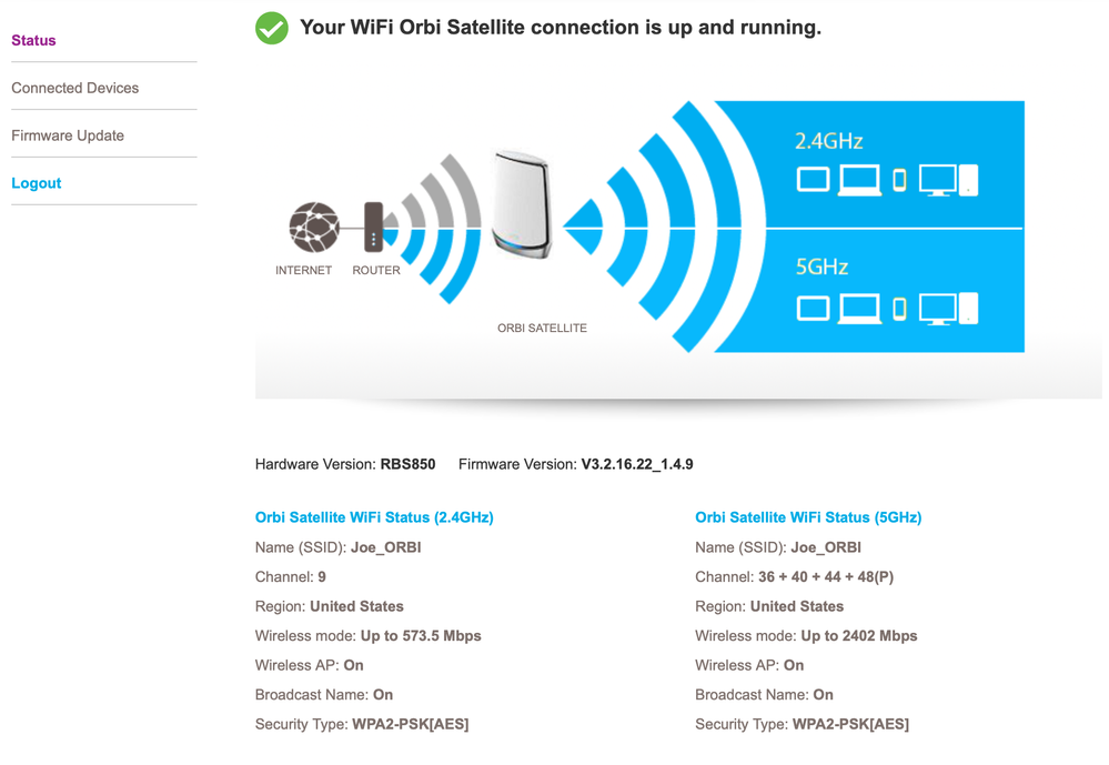

Sat 1, came with RBR850 when I bought it. Note SSID name and channels.

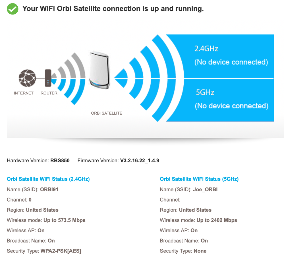

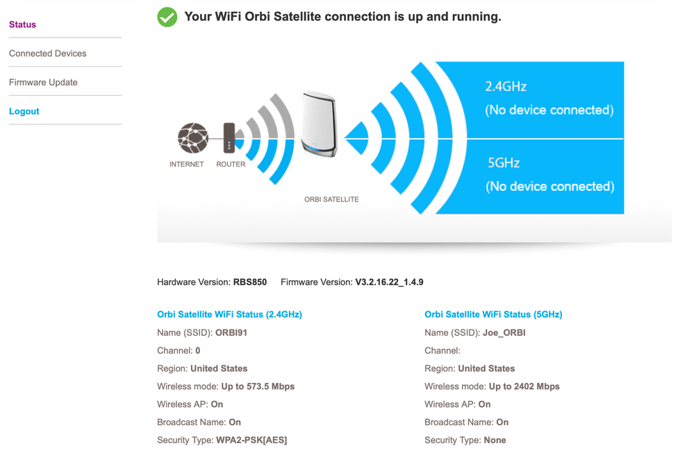

Sat 2, purchased separately. Note SSID name (2.4GHz) and channels (both 2.4 & 5GHz) compared to Sat 1.
How can I get Sat 2 to show the same SSID on 2.4GHz and channels as Sat 1? The 5GHZ channel is completely blank. I assume the 2.4GHZ channel of zero also means blank as well.
