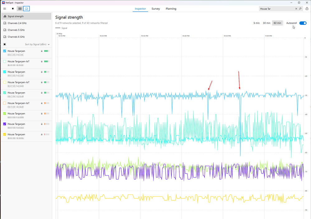

      I was watching Netflix when everything stopped working.  I was having Netspot monitoring my connection as I was watching. The monitoring PC is very close to the  router, not to the streaming device.  I observed this massive drop in signal strength where you can see it dropped from -30db to -65db at the time of the issue.  I also see spikes at other moments.  Is this normal?  (in all fairness, I haven't really monitored this long in the past).  I am wondering if these spikes could be what are causing the issues with google cameras, and my streaming services.

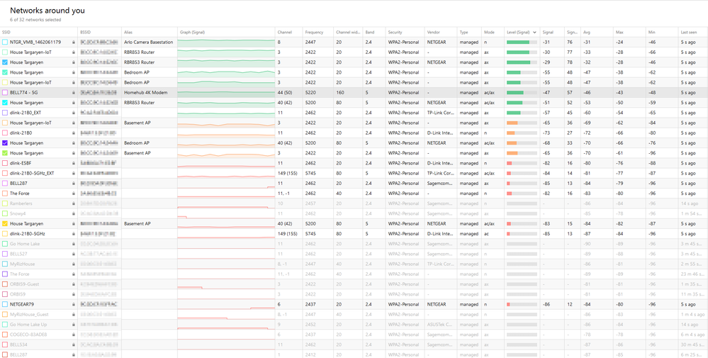

      My provider modem / router is a Bell Homehub 4000, which is really a Sagemcom Gigahub.  As it is a router as well, Orbi is setup to use PPPoE passthrough, and gets it's own external IP address.  I have disabled the 2.4 Ghz channel on the Bell Modem, and left the 5Ghz open for wireless access.  I might change this to leaving only the 6Ghz channel open, as my phone works with it and then this will reduce interference in the 5Ghz space as well.
      My home is roughly 2400 Sq. Ft over two floors and the basement is another 1200 Sq. Ft.  I have played a bit with the location of the basement Satellite.  It claims to have a good backhaul connection.  I may run an ethernet run to it regardless.
      Channel 3 was the 'auto' channel.  I'll set it at Channel 1.  I already have moved the 5Ghz channel to 48 as it seemed like a better channel.
      I have dabbled with the IoT channel, but not currently using it.  I just disabled it.  I will let it run like this for a bit to see if there are any improvements.
      Out of curiosity,  The spikes that I saw on the netspot signal graph... is this normal?

        Ok so lets disable ALL wifi radios on this ISP gateway. Leaving wifi enabled on it maybe causing problems.
        This size of home, the RBR and just 1 RBS would be and should be enough. IF you have two RBS deployed, try lowering the power on the RBR to 25% first.
        No, however maybe some interferences from the ISP gateway wifi causing some interferences. Can you test that again with just the RBR running?
