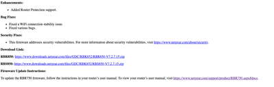

Upgrade to the latest firmware they said which they said was 7.2..7.15.
Interesting that when I open the orbi app and actually hit the go update button it says no new firmware available.
however if I go to the support pages, search my model and then go to downloads goes what? Several newer versions.
Once you open the zip file there is a mismatch of 750,800,850 models in the names, instructions and links that makes you squeamish.
Not to mention the random change your MTU and update DNS to 8.8.8.8...
Anyhow, I finally relented and manually updated all FW, unchecked the auto update (but have not yet had the courage to factory reset). Call me chicken if you like but going around and re-adding 20+devices is something that I would rather put off (at least until the weekend).
