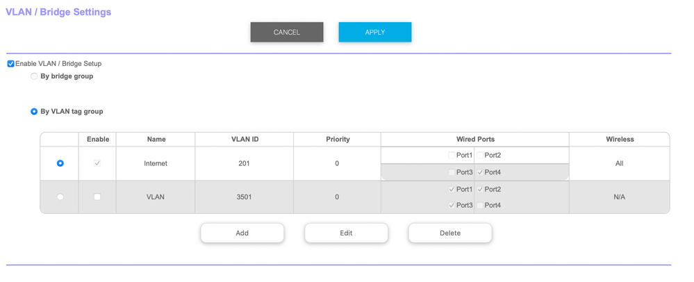

I was able to plug my laptop directly into the wall and everything worked fine. I did a reset and now I get a Self Assigned IP every time I plug my laptop to any jack on the wall. I just did a router reset and don't know why this is happening. Can anyone help? These are my VLAN settings below:

      I don’t have the CenturyLink modem/router being used at all though. It’s in a box packed away. The Orbi Router is the only device plugged into the patch panel in my closet. Everything was working before. I just don’t know how a router reset would cause my Ethernet jacks in the wall to no longer provide Internet and I get a self assigned IP when I try to use them now.

        You'll need to contact the ISP and have them help you ensure the RBR is connected correctly with there services. Ask if there is a PPPoE account log in needed that may have been set then blown away by a factory reset or any other interface devices that maybe needed to connect the RBR in place of there ISP router.
