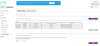

Satellites RBS850 keep disconnecting from routers and Web console says no new FW avail!!!
For months now my RBR850/RBS850 is unstable. My satellites disconnect from the router and all attached devices cannot connect to wifi anymore.
I have checked on the ORBI app and the ORBI Web console and my current FW is 7.2.6.31. When I check from both app and console for an update, they say I have the latest version. But when I check on the Support site it say latest version: 7.2.7.15.
So my question is: Does ORBI know what they are doing???
Instead of pushing new products on the market they should fix the one they have already there!!! This is a complete joke.
I am going to upgrade my FW for both router and satellites and it better work!!!
Not impressed!!!
