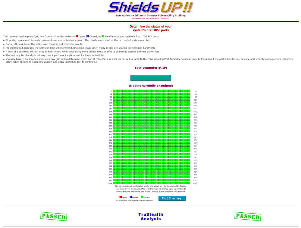

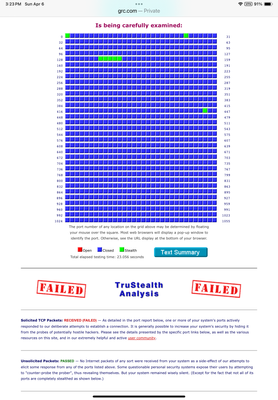

v7.2.7.15 Firmware on RBR 850. Can someone run GRC.com Shields Up
Can you please run Grc.com’s shields up and let me know if you can get full stealth?
https://www.grc.com/x/ne.dll?bh0bkyd2
This is the best I can get.
I am running Armor. Is that causing ports to appear closed?
Odd. I tested today and it’s all stealth.
But unsolicited packets failed. A complete 180 from before.

So I go a bit of information back regarding this. Seems that this is expected behavior seen at the port test site. Since Protection Engine seems to be a hidden feature in Orbi FW, this is actively preventing nefarious scans from intruding into the system. Thus will change the port behavior from stealth to close. Seems that protection engine identifies the port scan behavior as potentially risky and rejects the traffic to prevent possible attacks from internet from RST packets.
I happend to test this out on a Nighthawk router that has this feature and is user changeable to enable or disable PE. With PE enabled ports showed as closed and thus the test fails. Disabling PE, the port all then showed as stealth and the test passes.
Unfortunately there is no user changeable item on Orbi AX/AXE and BE systems to disable PE and I presume form NG intentions, means to leave this running the background as a added security layer for there systems. Older Orbi AC systems never imployed PE so those will report all stealth and thus will pass at GRC.
So Orbi AX/AXE and BE users will just need to be aware of this feature and the results seen with the port test site at GRC. This systems are safe and working as intended from what I understand.

Two days in a row. This time true stealth. I tried to upload the screen shot last night and this morning and it just says that the media is uploading for extended periods of time.

It basically is all green (full stealth) and it says it passed. This is on the 850s with firmware 7.2.8.5_5.1.21
Good to hear then. Seems like my passing and pressing on this with NG may have had some results.

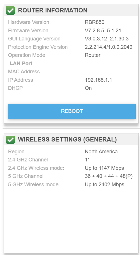

You don't happend to see anything regarding Protection Engine on the routers web page under Advanced Tab/Left window information box? Or maybe something under Advanced Tab/Security?

I don't see anything anywhere saying Protection Engine. I can check the debug page if you give me a path.
Router ip address/debug.htm

Found the debug
Basic Information
Firmware Version: V7.2.8.5_5.1.21
Boot Loader Version: V1.0.13
seal: v2.1.10.12-0
armor-bd: v2.2.214.4
spc-circle: v3.32.0.4
guster: v1.0.0.2049

guster: v1.0.0.2049 is supposedly PE.

Protection Engine is seen on the RBRs web page, even on prior FW version:
