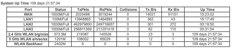

If a device wired to a satellite does not exhibit the problem, then the specific cable used for backhaul may not be the cause. The description does not mention any switches between router and satellites, so it would be helpful to double check the cable by looking at the Orbi web interface, Advanced Tab home page, blue box titled "Show Statistics".
Does it report the LAN ports that are connected to satellites as "1000M/Full" ?

My first time looking at statistics. Interesting ... well I say that, I don't really know what I'm looking at!
I'm guessing it's showing three LANs because it's including our doorbell as well as the two satellites.
You ask if the LANs are 1000M/Full, and clearly one of them is 100M/Full. Does this relate to the cat5e backhaul to the satellite on floor 4?

I should note that I've just learned on closer inspection that the cabling to the satellite on floor 3 is in fact cat6. So that's nice!If the link between router and satellite should be 100 Mb/s only, common cause is not the CAT5e label on the cable. In general, a Gigabit Ethernet link requires for correct wired pairs. Impossible to say what is connected, you are much nearer to your installation - briefly disconnecting the link in question would answer what is connected.
