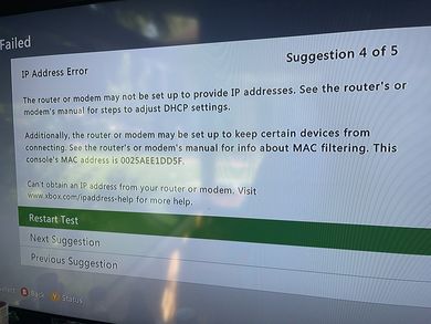

I have an up-to-date XBox 360. The XBox gets internet connectivity when wired to a satellite, and if I switch the nearest satellite off, has wifi through the router (presumably the router, but could have been the other satellite, although not great signal). However, when I switch the satellite back on, we get an "IP Address Error" (again):

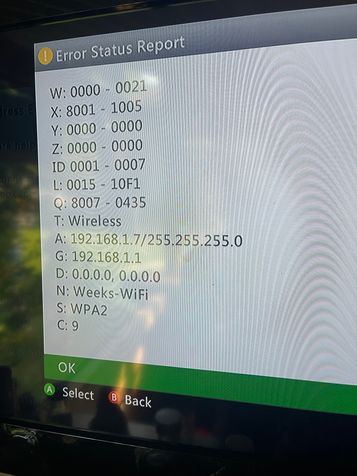

I noticed that it in the Netgear Router admin site it was saying it had an IP address, but on the XBox it was showing the IP address as 169.254.*.*. I then setup a fixed IP for the Mac address (ref: How do I reserve an IP address on my NETGEAR router? | Answer | NETGEAR Support) and manually configured the IP address on the XBox (IP address: 192.168.1.7, subnet: 255.255.255.0, gateway: 192.168.1.1). However, this did not resolve the issue. The Error Status Report is as follows:
