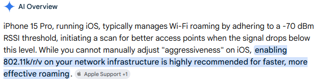

I have the 77X mesh router and satellites, and whenever I move from upstairs (where the main router is) to ground floor (satellite location), my phone ‘s wifi disconnects and takes a long time to reconnect (I often just forget the network and reconnect with password, otherwise it takes more than 5 mins). I have the latest firmware and this issue has existed for a long time and was hoping that latest firmware would fix it permanently, but so far no luck.

    Could be that the phones built in roaming protocol doesn't call for them to switch to a stronger signal yet. If the older AC tech didn't broadcast as far, they might not roam as often with a newer/faster system.
