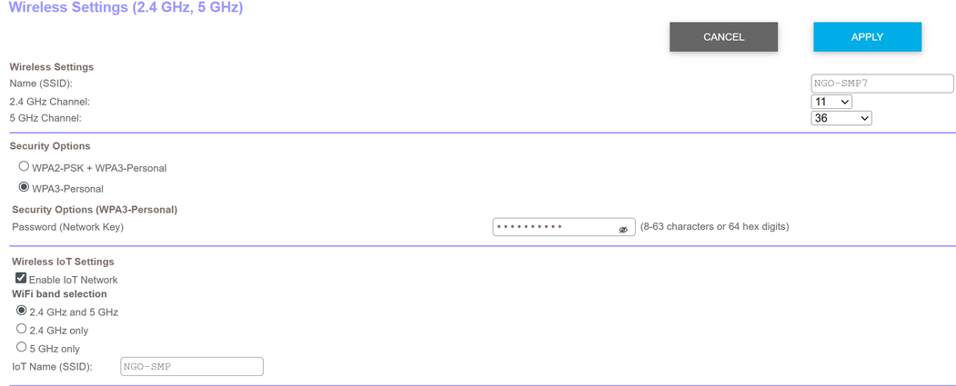

I'll have to see which causes more issues for me:
- switching on 5Ghz on IoT or...
- WPA3 only on the main SSID.
I suspect some piece of gear is not going to like either of those options, but if either works, it is worth reconfiguring those devices rather than having spotty connections on the phone. I'll give those a go and report back.

I was able to keep my phone on the IoT (WPA2) network all day yesterday. Today, I've switched the main SSID to WPA3 only and so far it's still a nightmare of poor connectivity. So much so that I put a fan on top of the 971. I have zero faith in that, but easy to do. If anything, it seems worse.

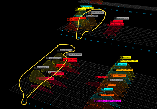

I'm sticking with WPA3 for the moment although I'm not sold on that fix - it could be coincidence. The behavior I was seeing, if I were just guessing and knew nothing else, would be that it seemed like some sort of interference; working good one second and then dropping out even when I was not moving around the house. So I got this "WIFI Commander" app for my PC that shows all networks...
My Orbi SSIDs are the NGOxxxx ones along with Sonos's hidden network, I think, and the backhaul - all on ch11 and ch36 now.
The "hidden" networks I circled in Yellow and very LOUD and should not be there (the weaker other SSIDs are neighbors). It turns out the Xfinity XB7 modem WIFI, even when disabled and especially in Bridge Mode will not be disabled. And they often come up automatically on the same channels I am using for Orbi. When I saw this and manually set the Orbi channels away from them, things improved quite a bit. Fingers crossed I'm back to normal - at least until the XB7 looses power and reboots back onto my Orbi channels. Someone on Reddit posted a way to open the XB7 up and unplug the antennas to stop it, so I may have to do that, but at least I can see what is going on and work around it.
I won't say this is the definitive solution, but there's no way Orbi would work well with another very LOUD network blasting on the same channels. Still not sure why newer iPhones and iPads were uniquely affected, so there may be more to it or a combination of issues including WPA3.

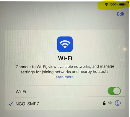

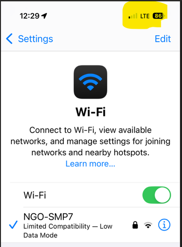

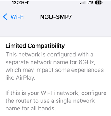

No. There's something incompatible with the newer Apple devices, that's all I can see. For example, today my iPhone shows connected to the WIFI, but with no internet and "limited compatibility" and some odd message about separate network names:
But my iPad is fine, sitting right next to the phone:
Rebooting the Orbi fixed that issue with the "network names and limited compatibility" - so some of this behavior is certainly an Orbi issue. I have no idea what got it into that state.
What I have found to be reliable over the past several days is keeping my iPhone on the IoT connection, so no WIFI7 I assume. And my older iPad is only using 5G. My wife's newer iPad has the same problem as our phones with the WIFI7 network.

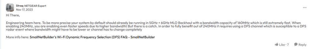

It's the only setting I see for setting the bandwidth, so I disabled it, and I'm not sure if that will help or is only for Backhaul. I have wired the backhaul lately, so that won't matter. I did see this post, but not sure if or how it applies to my setup or if we have DFS RADAR events:
Thats for MLO Backhaul, thus 5+6Ghz between the RBR and RBS.
It was recommended to me to not use that check box. Let the system handle the wireless BH configuration.
