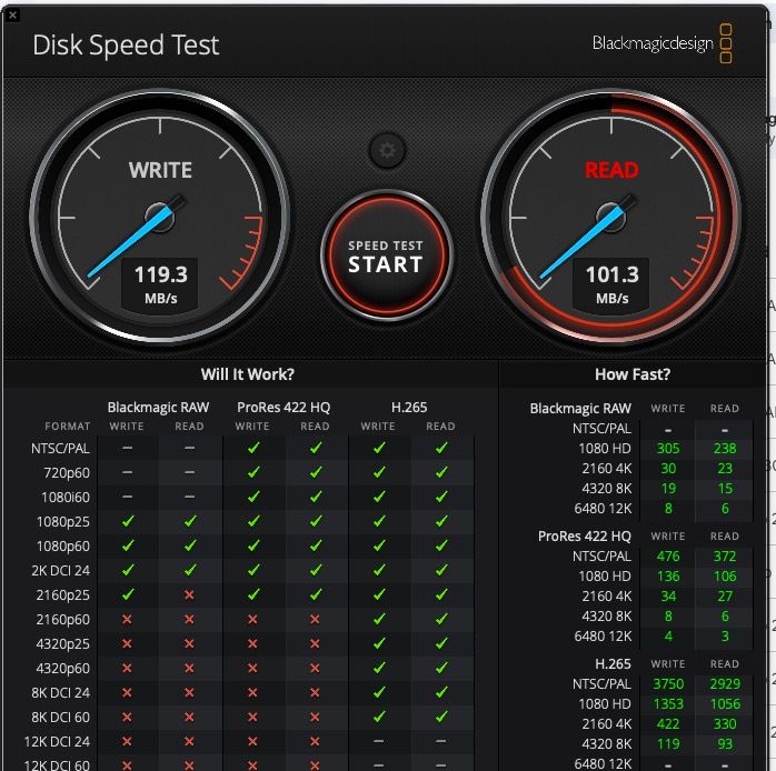

    Here is a blackmagic speed test (running on my macbook pro M3 Pro ) trying to copy/read 2GB onto the NVME SSD in the QNAP TBS H574Tx NAS.   . My Macbook Pro M3 Pro chip is connected via WIFI to one of the ORBi satellites.  I am trying to stream 4K video from the QNAP NAS about 20GB video to VLC on my Macbook and its lagging.
      The ~100 MB/s speed you are seeing here is the max you can get over gigabit ethernet.  So the the issue is not the QNAP and it is not the network connections between the QNAP and the macbook pro.

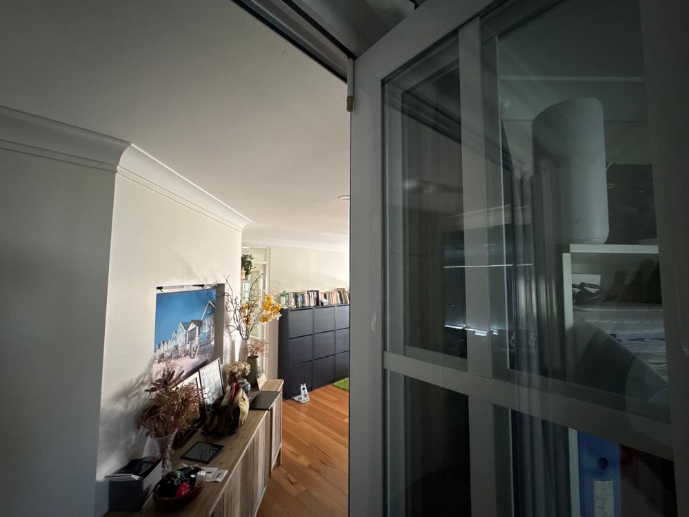

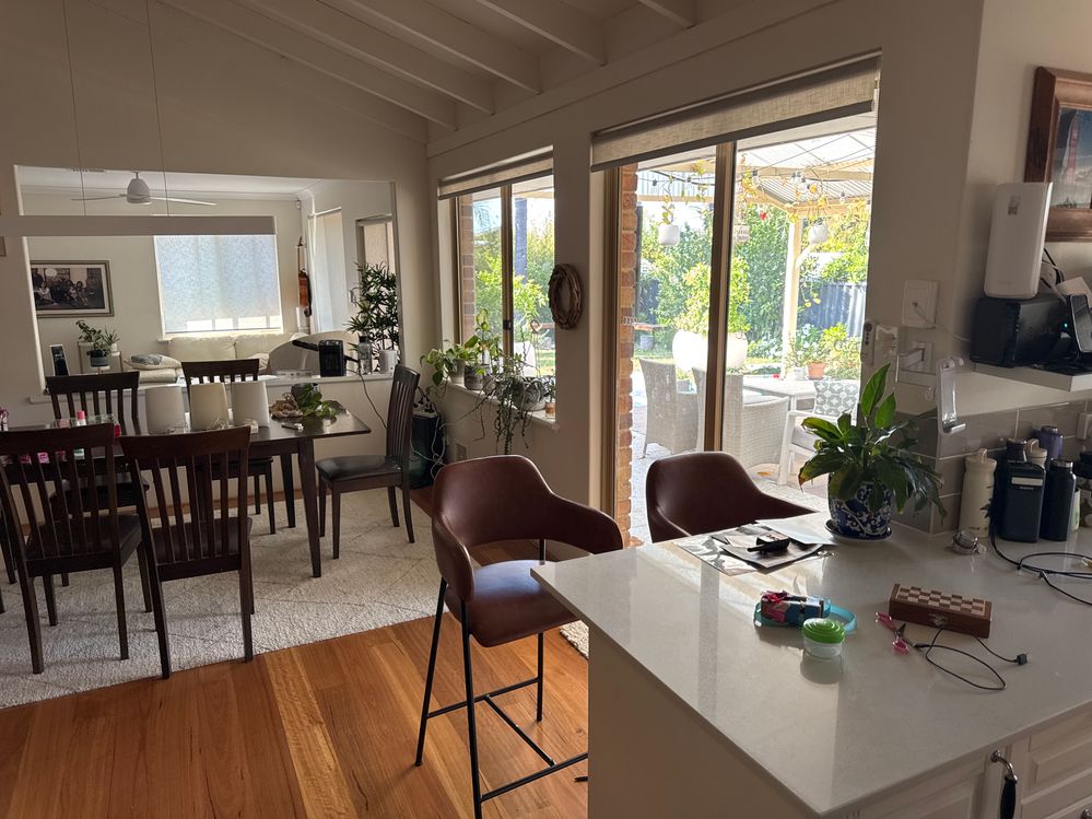

  • You can see the main router ln the shelf in the kitchen and the final satellite is in the far right corner of the livingroom.
    • FURRYe38's avatar

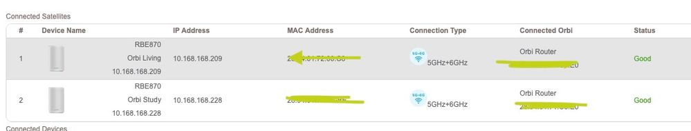

      What is the size of your home? Sq Ft?
      What is the distance between the router 📡 and satellite(s)🛰️? 30 feet or more is recommended in between RBR 📡 and RBS 🛰️ to begin with depending upon building materials when wired or wirelessly connected.
      This would be too close. You may need to turn this RBS OFF.
