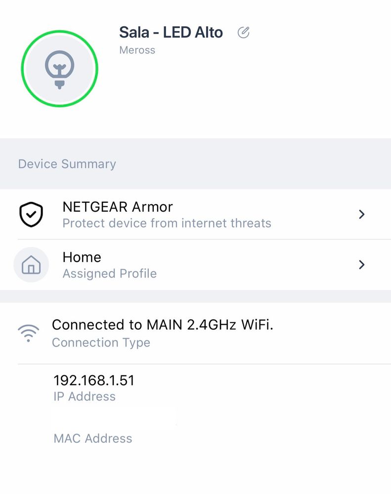

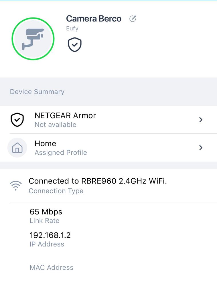

  • HeyFURRYe38​, going to another issue…
    Did your 770 RBR shows correctly the 2.4Ghz connection speed of devices?
    I will try to attach here 2 pics: one is from my 770 RBR and other is from also mine 960. Only the 960 shows correctly the speed while 770 don’t.
    And you know what is really funny? If the very same device connects to the RBS, it shows the speed normally.
    Are your set with same issue?
