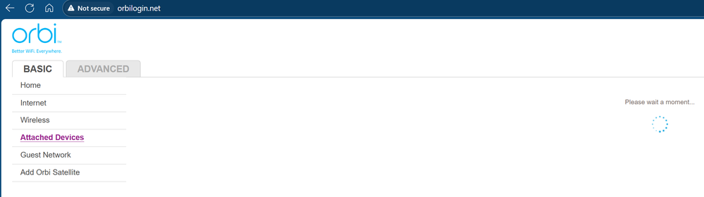

Then I noticed some strange behavior. When I was going through my devices and making sure they reattached to the networks (using the same SSID / PW as I did on the old Linksys mesh), I noticed that the satellites had no IPs. Just 0.0.0.0. I also noticed that when I clicked out of those pages and tried to go back in, it just spun. I let it spin for almost an hour. Most likely timed out. So, I rebooted. It did the same thing after about 15-20 minutes.

Long story short, I did a complete reset on the Router and Sats. Set it all up again from the app, and I am still seeing the Sats drop off from the orbinet and I can't see my connected devices.

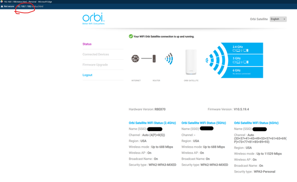

Note that I did go to manual firmware update and was able to IP connect to both Sat1 and Sat2. Strange since the main page doesn't show that. I can also see devices connected but it doesn't look like a all the devices are accounted for between the Sats or the main Router.
