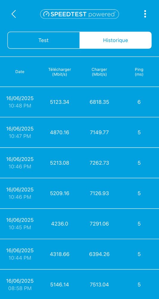

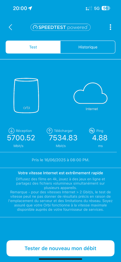

  • I received today the replacement router RBE971 and configured as AP with my 1 existing satellite.
    NG sent only the router and I used my existing power adapter (with new design and increased amperage)
    I have executed intensively Speedtest via WebUI and Orbi iOS app. Until now I couldn’t crash the new router. See below consecutive Speedtest via app
