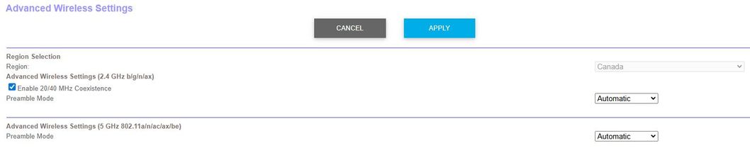

My satellite is saying it is in Canada. Any idea how I change that? Also, does the connection from the router to satellite look good?
Whats the lay out of the home and where are the RBS located from the RBR? Distances should be 30 feet or more up to say 40-50.
Size of home in sq ft?
Might power OFF the system for 1 minute then back ON.
Possible once the system is setup and staged, and once you fully on line with the system, CAN should change to USA.

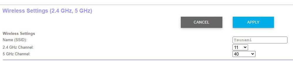

All set up now. Noticed the aggregate link speed has doubled on my Wi-Fi 6 devices from 1201/1201 to 2402/2402 (Mbps), and speed tests are substantially faster which is great. I have a couple questions. One should I be able to see a 6Ghz wi-fi option on my router and be able to select channels? Two my region is still showing and locked on Canada. I have opened a ticket with Netgear support, but if you know how I can fix that I'm all ears.
- plemansGuru - Experienced User
It doesn't give you an option of changing 6ghz channels. Mine looks exactly the same (other than the canada issue)
Might try a power OFF of the orbi system, RBR and RBS. I'd even power OFF the ISP Modem/ONT for 1 minute then back ON, then power ON the RBR first, then RBS soon after, give about 10 minutes for the system to settle in. Check the location.
Keep in contact with NG support.
Is it both satellites showing canada? And only the satellites? If so, I'd try factory resetting them and then hardwire them into the main router to sync them. See if syncing them hardwired pushes over the correct region (if the route is set for NA)
- wRiNkLe_sTiCkApprentice
I only have one satellite 1700 sq/ft single floor ranch. But the RBR and RBS both show Canada. I'll try shutting down as FURRY suggested.
Just to confirm, you are located in the USA?
yes, I am

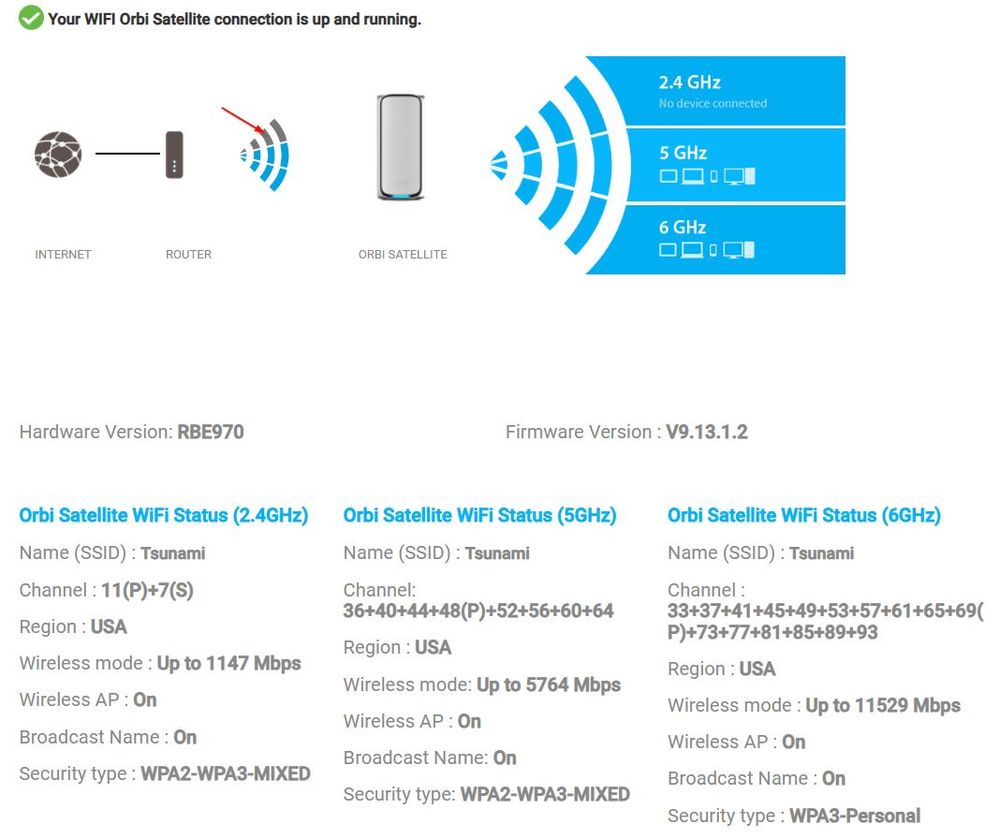

OK, so the full shutdown corrected the region. Thanks for the suggestion. I had done that once already, but I guess it needed to be done twice. Can either of you comment on whether this should be blue
Good to see. Glad it changed over.
2.4Ghz is showing that you don't have any devices connected. So the 2.4Ghz maybe idle or just waiting for a connection. Also since this is a WiFi 7 system and also supports MLO, Multi Link Operation, The wireless backhaul connection is combined to use 5 and 6ghz at the same time. Thus MLO, If the signal wasn't good, then the RBS backhaul connection could be 5Ghz only thus SLO, Single Link Operation.
Ok, there are 2.4Ghz connected now and it still appears the same, but everything appears good connecting with great strength and fast speeds.
