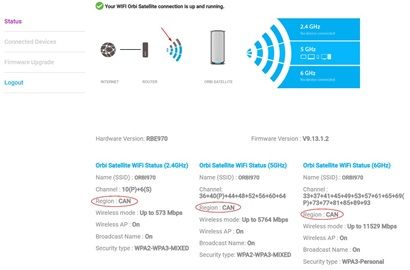

  • My satellite is saying it is in Canada. Any idea how I change that? Also, does the connection from the router to satellite look good?
    • FURRYe38's avatar
      Whats the lay out of the home and where are the RBS located from the RBR? Distances should be 30 feet or more up to say 40-50.
      Size of home in sq ft?
      Might power OFF the system for 1 minute then back ON.
      Possible once the system is setup and staged, and once you fully on line with the system, CAN should change to USA.
