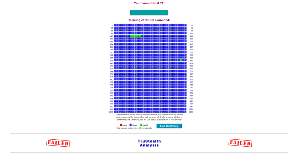

Ports report 'closed' instead of 'stealth'
I just installed the RBE771/770 and ran Gibson Research's (grc.com) Shield's Up! 'port authority' scan.  It reports that all ports are "closed", which means they are detectable by scans from the Internet.  With my previous routers, including a previous Orbi system, GRC reported that all ports were "stealth".      What do I have to do to get the RBE771 to stealth it's ports?

      No, I'm doing the test with my usual devices connected to the RBE 771, which is connected to a cable modem.  Why would disconnecting devices on the LAN side of the router matter - the router should prevent those devices from being visible, and those devices certainly are not using every port.   I've always gotten full stealth without diconnecting those same devices when using my previous router.
      Yes, it passes the uPnP test.    Here's the screen shot - as I said, it shows all ports closed instead of stealth and failed the true stealth analysis.

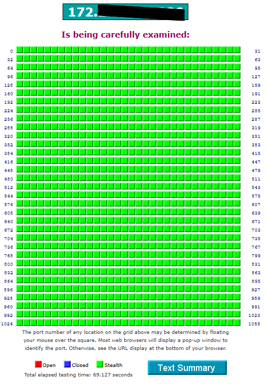

    It appears that the RBRE771 firmware may be configured differently than older Orbi routers.  My RBR50 and RBR750 routers both "stealth" every port that has not been deliberately port forwarded or opened for VPN.

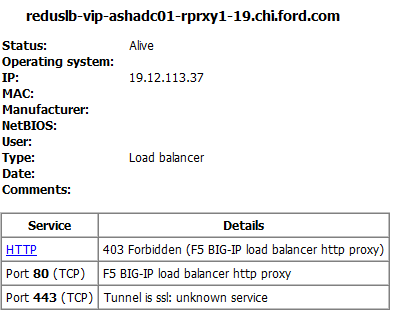

    GRC is a convenient "easy to use" tool.  Users can duplicate this using any Port Scanning utility.  For example, this is how ford.com scans:
    Probably something an engineer at Netgear might find interesting.

      Beg to differ.  GRC on my RBR50 shows the first 1056 ports Stealth (and has since the first time I found out about GRC years ago.)

      That's simply not true.  My Orbi RBR50, which I had for years and just replaced, ALWAYS showed all ports as Stealth.

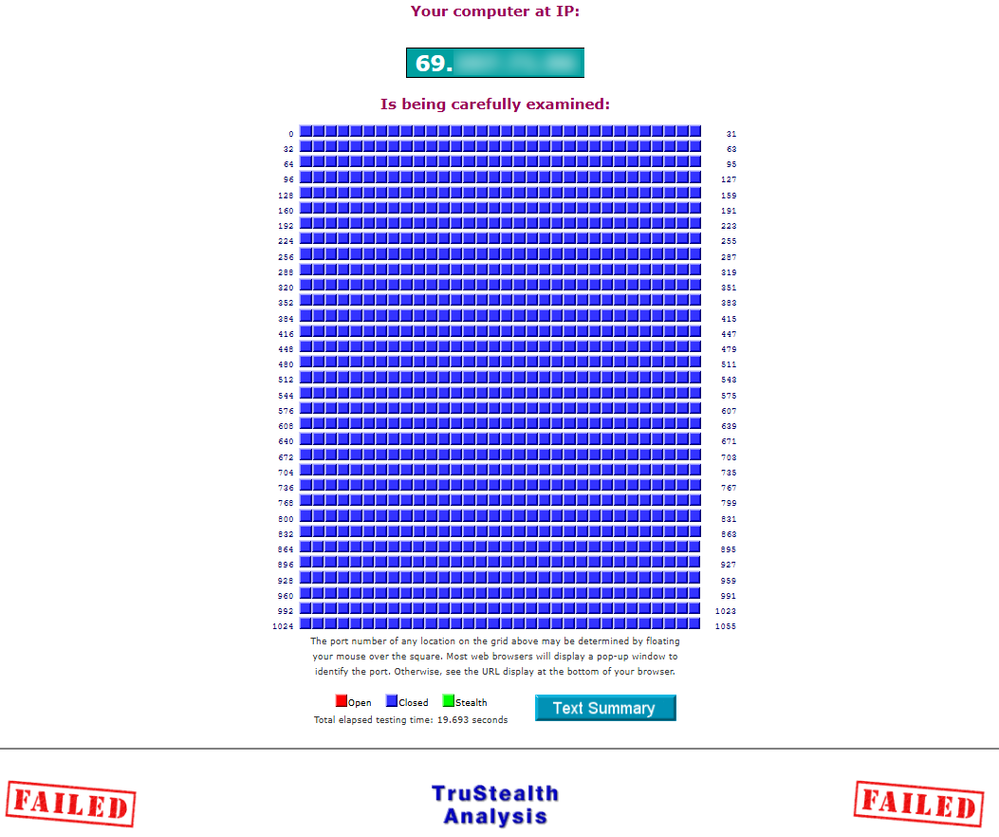

        And for one of my Orbi BE Systems, here is results for it:

      So you'll need to be patient or find a different router that has good testing results with GRC. My RS600 series gets all stealth with protection engine disabled on it. Works well.
