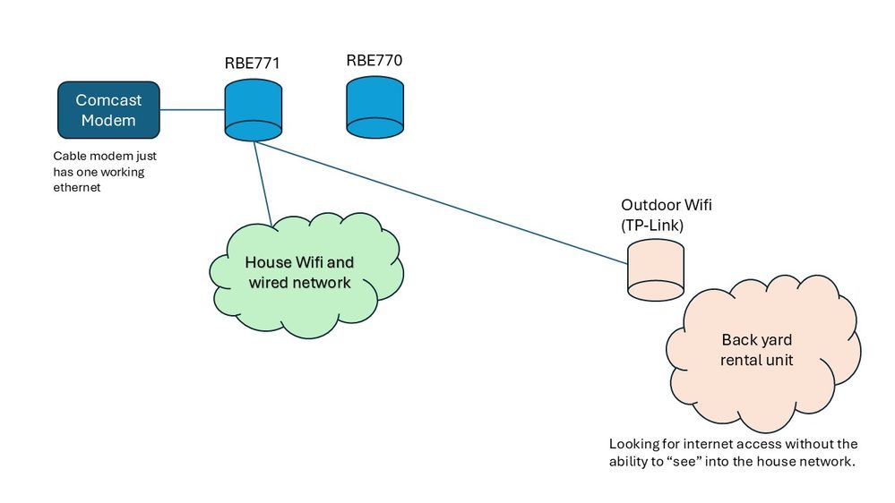

  • Here is a diagram of what I have right now.
    I see an idea on putting another router between the cable modem and the 771...
    I'm paying for a fast speed from comcast working from home so I worry that may slow down the network... and yes, my daughter is into gaming... :(
    I was hoping I could set a configuration in the 771 or the EAP610-outdoor from TP-link or maybe even put something between the 771 and the TP-Link.

    Is it a long term rental? If so, I'd recommend doing it right. Its a bit more expensive.
    You'd want to get a business class router that can do vlan's. You'd set the house on on and the rental on the other.
    then pickup a decent point to point system and go from the primary (business class) router to the rental with the point to point system (or just run an ethernet line).
    then simply setup a different non-orbi access point in the rental. or just use the tplink and use it indoors.
    You could pickup a used edge router x (older tech) for cheap that'd function as a business class router. Connect the point to point system (check amazon) for the  guest, and then connect the orbi to it (but put the orbi in AP mode).
    A bit of cost but would give you a solid connection for the rental if they're a long term rental.

    Thanks for the diagram.  Both Firewalla and pfSense sell appliances for under $500 which can be placed between the RBE771 and the TP-Link to prevent the rental unit from accessing the RBE771 networks.
    https://firewalla.com/collections/firewalla-products?srsltid=AfmBOoq50S-hJohMPCCTROeM3bFZF1vsgKB_BjKE65z80GVZXygkVzIR
    https://www.netgate.com/appliances
    This has the advantage of avoiding Double NAT for the Orbi network.  It does, however, definitely create a Double (or maybe Triple) NAT for the rental unit.  OK for 95% of users, but a definite limitation for those specific applications.  If the rental unit requires complete network access, the only solution is to have the ISP install separate service to the rental unit.
