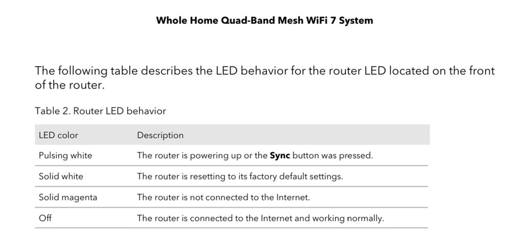

I set up my Orbi 973 system yesterday, which for the most part went smoothly. Strangely though, the LED at the bottom of the main router is solid white, and has been that way since setup. My 960 series didn’t do this, and according to the manual, it indicates the router resetting to factory defaults (which is not the case).
The router and satellites are working perfectly, so this is clearly an error. Is anyone else running into this? If not I may just do a reset on all of them and start over.
  • Update on this:
    I powered off the ONT for 15 mins, then powered on.  Rebooted router.  White LED remained on (solid).
    After I went through a complete reset and setup of the Orbi from scratch again (see my other post on the admin portal issue), the white LED is no longer on!  Seems that somehow the router was in a funky state or perhaps thought setup wasn't complete.
