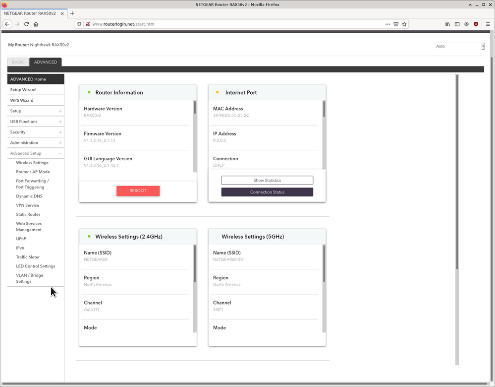

I just got the AX5400 a couple of hours ago.  I specifically got it for the wireless bridging capabilities.  There was nothing in the listing or on the packaging to indicate that this was the RAX50v2.  I specifically got it from the Netgear section on Amazon.  On the webpage for the wireless bridging I saw that RAX50v2 does have support for wireless bridging.  Is my only option to return the router? Or are the they firmware compatible and I can reflash the RAX50v2 with the RAX50 firmware?

    What does the label on the router say? If it doesn't say V[something]  it is V1.

      Attached is a screenshot of what I see when I login to the router. Following the online guide Advanced > Advanced Setup > Wireless Bridge, but it isn't there.
      • michaelkenward's avatar
        michaelkenward
        I'd expect to see it in either the Router / AP Mode slot, which is where it is on my R7800, or, if the manual is correct, in Wireless Settings. (That's not to be confused with the VLAN / Bridge Settings bit, which is something else.)
        Looks like another Netgear manual that needs an update for the new hardware version.

    Do you not see wireless bridge mode on the router WEB UI?
    No.
