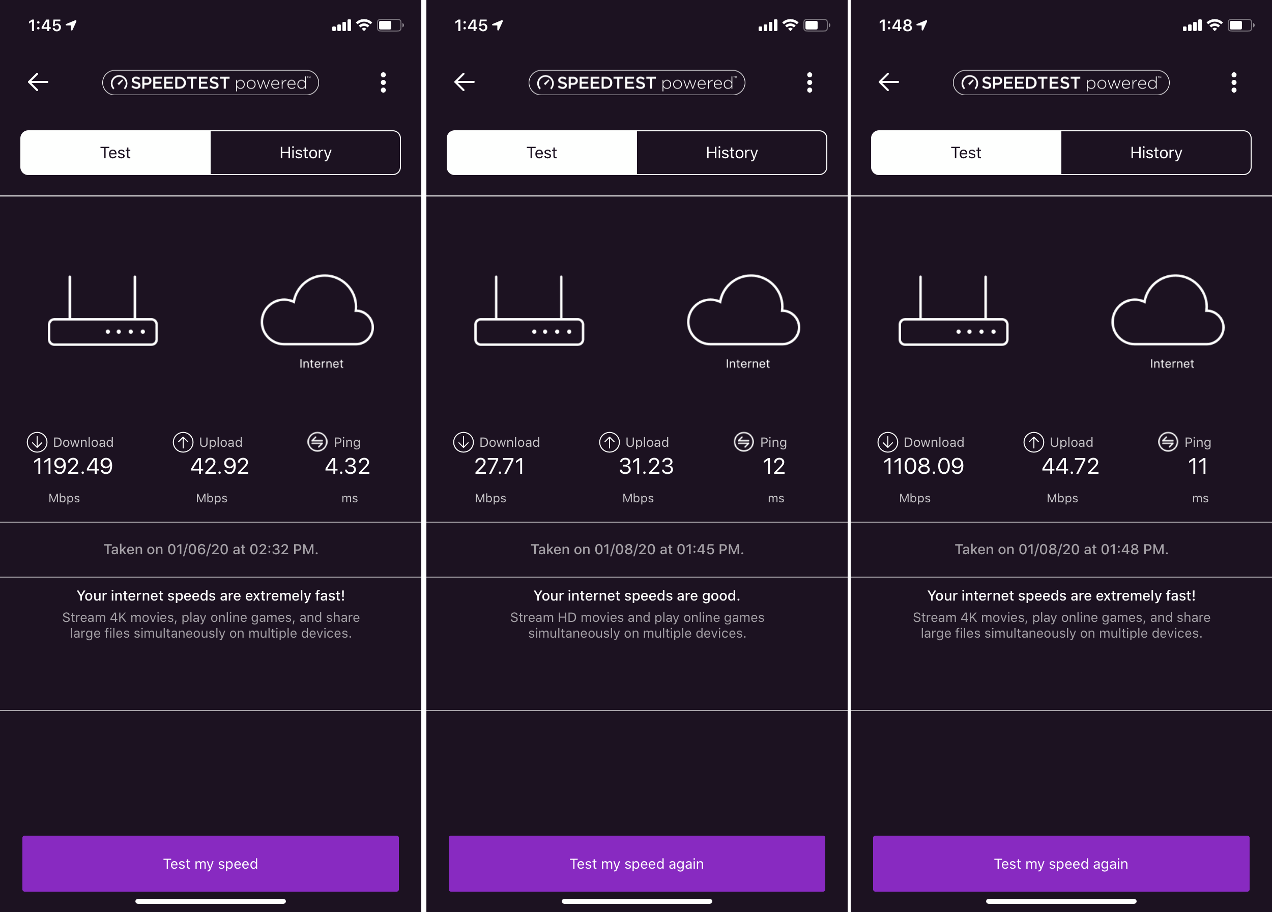

CM1200 to Rax200 WAN aggregation slows down (requires reboot)
I have a CM1200 modem and RAX200 Router with WAN agreggation (2Gig). My internet speeds slow down to 25Mb after approx 24 hours. Rebooting the router fixes the issue for another 24 hours and then the 25Mb speeds are back. I have to reboot my Router* once a day. This is incredibly frustrating!
Also* QoS seems to be disabled-unavailable when using WAN aggregation on my RAX200. (please fix this)

      I have a RAX80 with the CM1200.  Same issue, it slows down to 30Mbps after sometime and have ot reboot.  In addition when link aggregation is setup, xfinity speed tester reports lower speeds than when it is disabled.

        I too am seeing a decrease in download speeds when WAN Aggregation is enabled between a RAX120 router (1.0.1.114) and a CM1200 modem (1.02.02) with 1000Mbps service from Xfinity, as measured by the Internet Speed test on the Nighthawk App (2.4.19.1).

      I was on the phone with Netgear support for over two hours earlier this week.  The first hour and 20 minutes, I was on hold.  They had me reset the modem and router and run one speed test after another.  Of course the speeds were decent because I had just reset the router.  But fast forward two days and my speeds dropped from 1200 Mbps to 18 Mbps.

  •  Seems lots of us at having the same issue -- I have RAX120 (firmware v1.0.1.122) with CM1200 Modem -- WAN Aggregation works great (up to always near 1200 mbps) for half day to day, and then top download speed goes to 18 mbps -- Reboot the RAX120 and speed goes back up again, only to repeat.

      But a reboot of the modem does work. I can reboot either the modem or the router and it will fix (no need for both). I put my modem on a smart switch and have it power cycle the modem to address this issue (its timer based since I have no way to automate detection of the drop yet).

        Just a reminder, simply unplugging and replugging in one of the Ethernet cables also fixes the issue.  Still annoying, but slightly faster.

         My recommendations would be the Asus GT-AX11000 Wi-Fi 6 Router paired with cm1200. I heard it works. Hence the issue we have is netgear hasn't communicate anything about the "fix". Their release notes state that there are no issues but we know there is an issue. It's been going on for months and the rumor is they have "fix" but it to my understanding hasn't been stated anywhere. The rumor is the cable modem fixes the problem even though the cable modem works with other routers. My guess is the modem "fix" is to force a disconnect once a day or so. That forces router to rebuild the connection stack. We know that if you pull the cable from the router to the cable modem it starts to work again for about a day.
