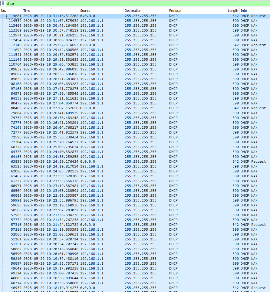

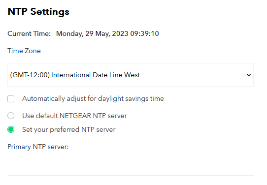

  • Upgraded my RAX45. All good so far except for the custom NTP settings. No matter what I choose or set, after clicking save it blanks out and timezone reverts to default. However logs show successful sync and the time/timezone is correct so it may be a gui only bug.
    My DHCP log entries are excessive as well for mainly just a single Win 11 laptop but it did that on older firmware as well. Confirmed via wireshark that the laptop is indeed sending DHCP requests for its own IP (but from 0.0.0.0 as if it doesn't have one) every few minutes for whatever reason. It acts like it is dropping off the network, but it isn't (constant ping to GW proves this), and the router is responding with DHCP NAK as if the address is taken...well it is, by the very laptop that is requesting it.
    Just moved the laptop closer to the router and it stopped doing this for about 30 mins (it switched to 5ghz band). I moved it back further away to where it was originally (maybe 20 feet) and it started doing it again (it switched to 2.4ghz band). Interesting...
    [DHCP IP: (192.168.1.15)] to MAC address XX:XX:XX:XX:XX:XX, Monday, May 29, 2023 10:31:16
    [DHCP IP: (192.168.1.15)] to MAC address XX:XX:XX:XX:XX:XX, Monday, May 29, 2023 10:29:57
    [DHCP IP: (192.168.1.15)] to MAC address XX:XX:XX:XX:XX:XX, Monday, May 29, 2023 10:27:02
    [DHCP IP: (192.168.1.15)] to MAC address XX:XX:XX:XX:XX:XX, Monday, May 29, 2023 10:24:29
    [DHCP IP: (192.168.1.15)] to MAC address XX:XX:XX:XX:XX:XX, Monday, May 29, 2023 10:21:25
    [DHCP IP: (192.168.1.15)] to MAC address XX:XX:XX:XX:XX:XX, Monday, May 29, 2023 10:18:20
    [DHCP IP: (192.168.1.15)] to MAC address XX:XX:XX:XX:XX:XX, Monday, May 29, 2023 10:15:31
    [DHCP IP: (192.168.1.15)] to MAC address XX:XX:XX:XX:XX:XX, Monday, May 29, 2023 10:13:49
    [DHCP IP: (192.168.1.15)] to MAC address XX:XX:XX:XX:XX:XX, Monday, May 29, 2023 10:11:09
    [DHCP IP: (192.168.1.15)] to MAC address XX:XX:XX:XX:XX:XX, Monday, May 29, 2023 10:10:16
    [DHCP IP: (192.168.1.15)] to MAC address XX:XX:XX:XX:XX:XX, Monday, May 29, 2023 10:06:30
    [DHCP IP: (192.168.1.15)] to MAC address XX:XX:XX:XX:XX:XX, Monday, May 29, 2023 10:05:42
    [DHCP IP: (192.168.1.15)] to MAC address XX:XX:XX:XX:XX:XX, Monday, May 29, 2023 10:02:52
    [DHCP IP: (192.168.1.15)] to MAC address XX:XX:XX:XX:XX:XX, Monday, May 29, 2023 10:01:49
    [DHCP IP: (192.168.1.15)] to MAC address XX:XX:XX:XX:XX:XX, Monday, May 29, 2023 09:59:27
    • FURRYe38's avatar
      What browser are you using? Happens in other browsers?
      Try a factory reset and setup from scratch to see if this resolves?
      • snowcr4sh's avatar
        snowcr4sh
        Tutor
        Chrome/Firefox. Upgraded my parents' RAX45 and it did the same. It came up with the wrong time - I set the NTP source and timezone, clicked save, it syncs and corrects but blanks out and shows defaults. So, not a big deal being a gui glitch - not going to factory reset.
