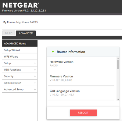

Hello Everyone,
       Another problem arose after plugging in the new nighthawk.
My physical network 192.168.xxx.xxx which goes to port one on my JGS524Ev2 and is trunked is now not working. I have it (the ethernet cable) plugged into a physical port on the router but it's not working at all and I am not sure why Can any give me some ideas on what to troubleshoot? I have been working and troubleshooting for about an hour and a half now. I cannot figure out the problem.
Thanks,
  • Hey Guys,
    I figured out the problem, I had it set for tagged instead of untagged. Once I set it to untagged the Physical network came up and started communicating.
    Thank you for responding. I do appreciate the help,
    Michael
