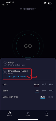

  • Hi p0se1d0nX ,
    Which Speedtest server were you choose? Sometimes use different speedtest server would gain different results.
    You can try the nearest one.
    This is my test result with 1Gbps/600Mbps internet plan via my iPhone 13 pro max.
