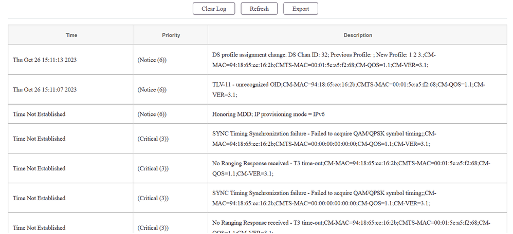

    Please post a copy and paste of the modems connection status and event log page.
    https://kb.netgear.com/30007/How-do-I-obtain-the-cable-connection-information-from-a-NETGEAR-cable-modem-modem-router
    https://kb.netgear.com/30008/How-do-I-view-or-clear-the-event-logs-on-my-NETGEAR-cable-modem-or-modem-router

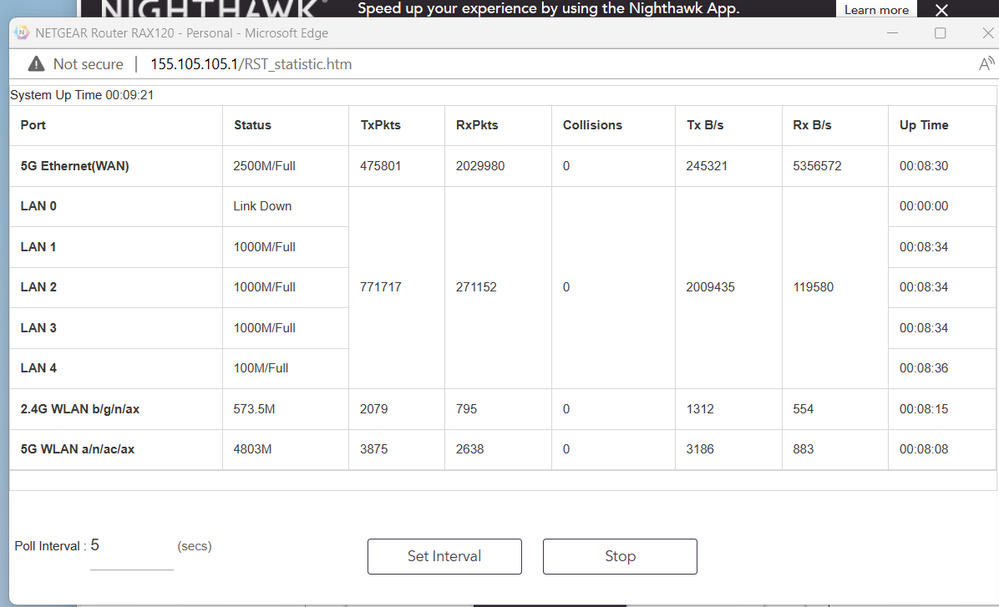

      The above is how it is presently running. The issue is when I try to use the MGig connection on the router the speed drops from 940 to 609. After a router reboot, the speed is 558. The Nighthawk iPhone app says its 940 on either the 1Gig or the MGig port connection. Below are the stats with the MGig port.
      Why do the 1Gig LAN router port speeds drop when using the MGig port on the router?

        Sorry. Not very good yet with this site. This is the setup that I'm presently using to get the 940 Mbps. The internet speed on my PC drops when using the MB port on the router.
