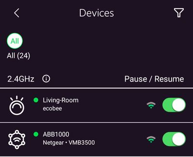

  • Are you referring to the pause/ resume options in the nighthawk app where internet connectivity can be controlled for each device?

        For that function, make sure the app islists that it is connected to the RAX50 when you press the home button in the app, Sometimes if a drvice gets factory reset, and then set up via the web UI while multiple routers or APs are listed in the nighthawk app, it may automatically switch to a different device in the list, even though it still has access to the main router, thus seeing the devices on your network but not having the option to control their access.
        Another potential issue, (more common if it is connected behing another router (common in cases where someone gets one of those modem and router combos from a cable provider, and does not set it as a transparent bridge. If the RAX50 gets set up in AP mode, then the access control functions will stop working.
        PS if you have multiple APs or extenders, try to conect to the WiFi AP created by the RAX50 directly and run the app so that it establishes a connection with the app locally at least once after a factory reset.
        As a side note, if the router ended up with any NVRAM corruption that caused some configurations to be lost, it is best to do a proper factory reset before setting it up again fully.
    • RAX50's avatar
      RAX50
      Your screenshot is what I had before the reboot.  Now it is gone.
