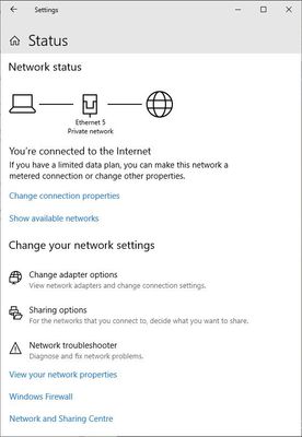

    • Brushtail's avatar
      Brushtail
      The windows network was indeed on a public network, but even though it was on a public network the wifi interface was connecting to the internet without any issues. The issue with the ethernet was it took over 2 hours for it to start connecting to the internet. Having set the wifi connection to private I have just switched to the ethernet interface and after waiting for it to connect to the internet, the network said it was connected to a public network which I have now changed to private. The question I have now is with all the router/modem_router changes I have done under various windows versions, why is using this router the first time that I have had to do this sort of windows network connection changes?

      Thankyou to everyone for the responses. I've just checked the connection options here and installing the new rounter and setting up the wifi interface has caused the windows network to connect on a pulic network even though the setup with the previous router was private. Also the ethernet interface is now connecting to the internet. It took over 2 hours from router installation and connecting windows 10 to the routers wifi interface for the ethernet interface to actually start working. It seems from my experience that the recommendations to connect to the router with ethernet in order to setup the router is not workable with the router I have out of the box.
